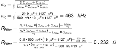

Hi, I have some questions related to the output filter to improve the ripple.
1) Equation 69, what is the unit of Wo Hz or KHz or MHz ?
what should be the unit of Cout_CER, Cout_BULK, Lf inside the equation ?
how should we size Cout_CER, I did not see any equation for it, how big should its ESR ?
2) Equation 70, what is the unit of Rf ?
what should be the unit of the parameters inside ?
What is Rout ? is this dependant on my load ?
Thanks!
