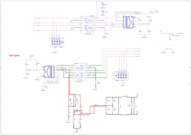

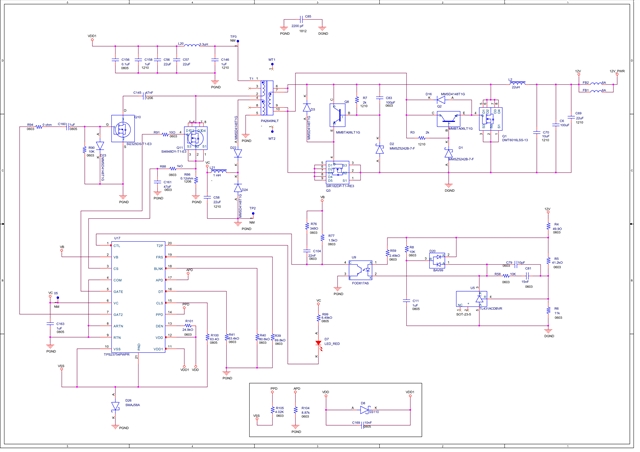

I am using the TPS23754PWPR PoE PD controller in my router designs.
  • In my Gigabit router design, everything works fine. The device powers successfully from both a PoE injector and a PoE-capable Ethernet switch (802.3at PSE).
  • In my Fast Ethernet (10/100 Mbps) router design, the exact same TPS23754-based PoE circuit is used. However, in this case the board only powers when using a PoE injector. When connecting to a PoE Ethernet switch (PoE PSE), the board does not power on.
So far:

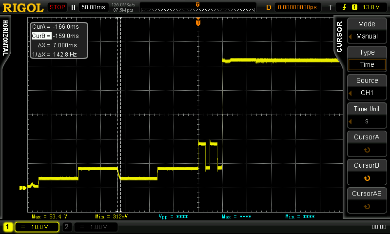

  • PoE detection/classification appears normal with the injector.
  • No issues observed in Gigabit version.
  • Only the Fast Ethernet PoE switch → board case fails.
Questions:
  1. Are there known differences between PoE implementations in Fast Ethernet (10/100) magnetics versus Gigabit that could cause this behavior?
  2. Do I need to modify anything in the front-end design (RJ45 magnetics, center tap connections, Bob Smith termination, etc.) when using TPS23754 with a 10/100 Mbps transformer?
  3. Could the issue be related to Mode A/Mode B powering or diode bridge orientation in the Fast Ethernet layout?
Any guidance on debugging steps or required schematic/layout modifications would be greatly appreciated.
Schematic
PoE Injector Detect WaveForm
PoE-capable Ethernet switch Detect waveform

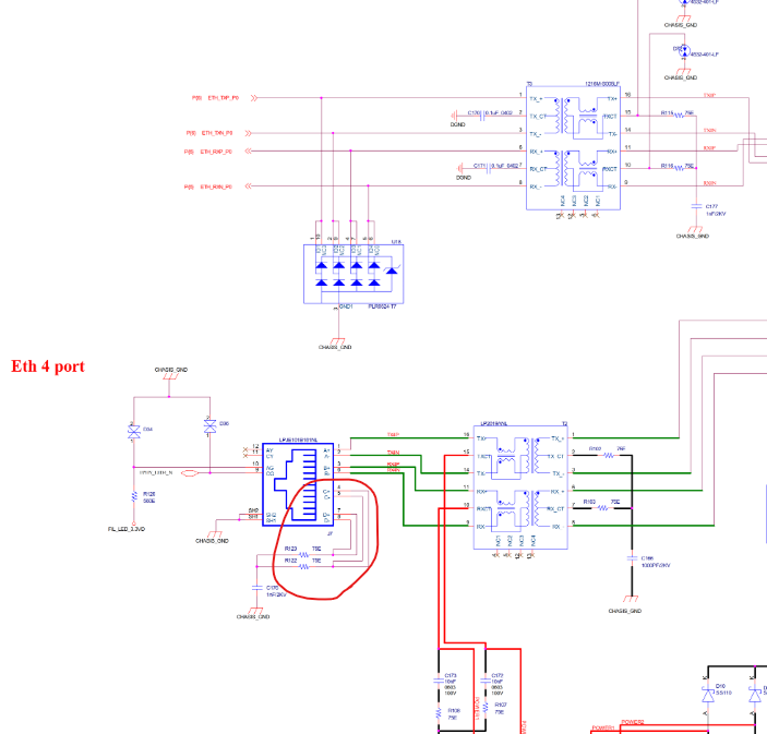

      A: You have posted only one design in the thread, here is the issue I found from the schematic:
    4,5-7,8 are shorted with two 75 Ohm resistor. When the PSE are doing detection, these 150 Ohm in total will cause detection issue. And please make sure all 4 pairs are terminated to the diode bridge correctly.
    Please refer to this reference design for the correct RJ45 connection.
    TPS23753AEVM-004: Evaluation Module for TPS23753A.. (Rev. F)
