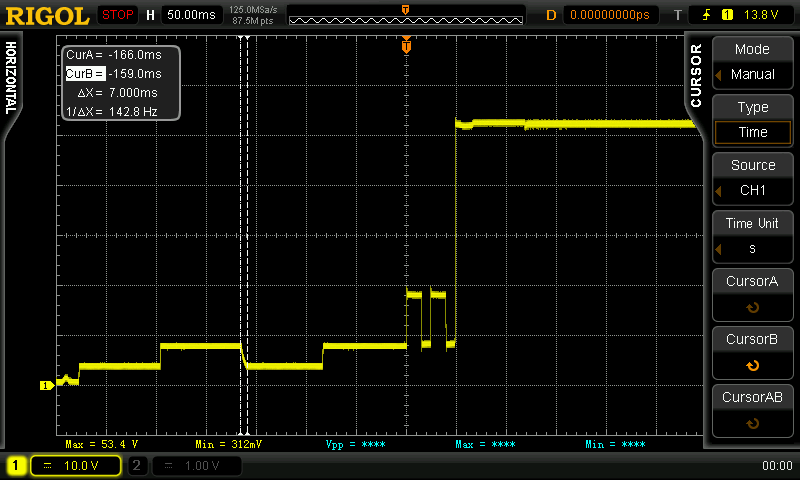

I am using the TPS23754PWPR PoE PD controller in my router designs.
  • In my Gigabit router design, everything works fine. The device powers successfully from both a PoE injector and a PoE-capable Ethernet switch (802.3at PSE).

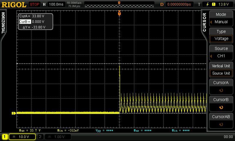

  • In my Fast Ethernet (10/100 Mbps) router design, the exact same TPS23754-based PoE circuit is used. However, in this case the board only powers when using a PoE injector. When connecting to a PoE Ethernet switch (PoE PSE), the board does not power on.
So far:
  • PoE detection/classification appears normal with the injector.
  • No issues observed in Gigabit version.
  • Only the Fast Ethernet PoE switch → board case fails.

Below attached the Schematic & Waveform for reference.
Schematic
PoE Injector Detect WaveForm
PoE-capable Ethernet switch Detect waveform
