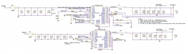

TPS62876-Q1: TPS62876 Stack Configuration SYNCOUT
Part Number: TPS62876-Q1
We have used 2 X TPS62876 to provide 0.75V@11A in a stack configuration. On PCB, there is mistake that tied the SYNCOUT pin of the secondary PMIC to GND while it is recommended to connect to GND through a 47k ohm resistor. I can measure my power rail is actually providing 0.75V, but not sure what kind of behavior we expect while tieing the SYNCOUT pin of the 2nd PMIC, any insight?
