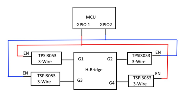

We'd like to confirm if the design below is applicable:

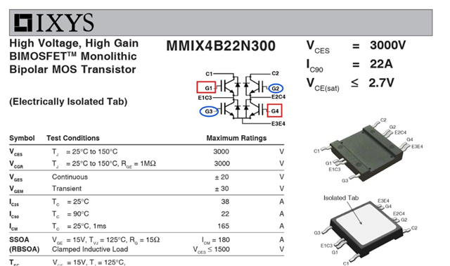

In our application, we are using four TPSI3052QDWZRQ1 devices, one on each gate, to drive gates G1 through G4 on the Littelfuse MMIX4B22N300 H-Bridge. In our application, we drive gates 1-4 and gates 2-3, as pairs.
Question:
Is there anything incorrect about driving a pair of TPSI3052s configured in three-wire mode, with one MCU GPIO?
According to the datasheet, the EN pin acts as a digital Input configured in a 3-wire mode, and I didn’t see any current consumption of the EN pin when using it in 3-wire mode.

  • Hello Archie,
    Thanks for reaching out to our team on E2E.

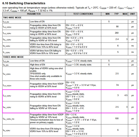

    I am unsure how much shoot-through would be acceptable in your application. Based on the TPSI305x EN to VDRV delay, there could be up to microseconds of mismatch between separate TPSI305x devices.
    I am guessing a dual output isolated gate driver like UCC21550-Q1 designed for half-bridge applications would be a better fit since it only has nanoseconds order of timing mismatch.
