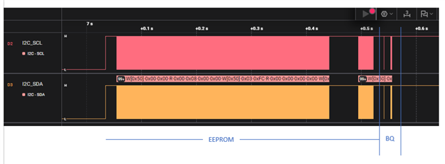

This is a follow up to another post I made titled "BQ25792: BQ25792 I2C appears to lockup when USB-C power is removed and restored quickly"  Since that post I have added the ability to monitor the I2C traffic between the TPS25750 and the BQ25792.   It was initially thought that there was a problem between the TPS25750 and the BQ25792 communications, but this is clearly not the case.
Our system uses a microprocessor to periodically query the BQ25792 via I2CW and I2CR tasks on the TPS25750 for voltages and charger status.  Normally everything works fine and we are able to communicate with both chips.   Intermittently the TPS25750 will return a status code of 0x03 signaling "Task Rejected" for a I2CW or I2CR task and after that no other I2CW nor I2CR tasks will complete successfully.  It's as if the I2C  "passthru" on the TPS25750 is broken.  The only way to get out of this mode is to remove the load on the BQ25792 (essentially powering off our unit).   During this failure mode the I2C lines between the TPS25750 and the BQ25792 are both in the high, pulled up state with no traffic whatsoever passing over them.   What is also interesting is that during this failure state, no communication between the TPS25750 and BQ25792 occurs.  Normally there will be traffic when I plug and unplug the USB-C cable for example.  During this failure state I can still read and write registers on the TPS25750.  It appears that only the I2Cw and I2Cr tasks are affected.

    Questions:  Is there a hold off time/delay before I can start querying the TPS25750 and using the I2Cw/I2Cr task commads after the unit powers up/load is connected to the TPS25750 and/or BQ25792?
    After the unit power up, the eeprom will be loaded and then the PD will send the initial config to the BQ.  This should be on the order of 550ms.

    Can you confirm that nothing is happening on the BQ side, clock stretch, NACK?  Is the I2C Controller NACKed bit set(unmask)?

    Thank you for answering my questions.   I implemented a 1000 ms hold off before communicating with the TPS25750 and BQ25792 however this did not eliminate the problem.  I am also very sure that we are not sending more than 14 bytes of data to the BQ25792.  All I am doing is querying the BQ25792 for ADC measurements and status bytes.  These requests are only a few bytes of data.  I also do not send I2Cw/I2Cr or write to any other TPS25750 registers faster than 10 ms between transactions.   Finally I tried using the "GAID" task command when the board got into a continuous series of 0x03 task reject loop and it had no effect.
    One thing I have noticed is that when we are in this failed state, and this may be the issue;  reading register 0x03 of the TPS25750 shows the mode to be "PTCH" and not "APP".   What I don't understand is why the chip intermittently does not go into APP mode.   We are pin strapping the TPS25750 with  both ADC1IN and ADC2IN connected to LDO_1D5 which should put us into "AlwaysEnableSink" .  Curious if we should pin strap for "SafeMode" since we load from an EEPROM?
