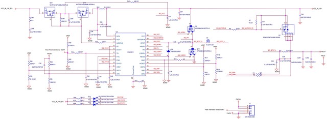

BQ24610:Circuit Design Verification
Part Number: BQ24610
Design Requirements:
  1. Power adapter: 15V, external battery: 12.6V, expected to drop to a minimum of 10.8V.
  2. Detection feedback when the power adapter is plugged in.
  3. Battery level feedback from 0% to 100%.
  4. Charging status feedback.
  5. Feedback for battery over-temperature condition.
  6. Charging stop mechanism when battery temperature is too high.
  7. None of the LEDs for BQ_PG#, BQ_STAT2, BQ_STAT1 are lit. Do you have any recommended directions for analysis?
  8. Based on the above design requirements, are there any circuit modifications needed?
