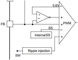

What is leak current of FB pin? I can't find in the datasheet. This value is required to determin feedback resisters value.

Hello Koyo,
We dont have exact value for the FB pin resistor, but you can consider it in Mega ohms.
-Hitesh
Hey Koyo,
You can consider the internal resistor of the Fb pin as 1MOhm but the external resistors dividers you connect should be in Kohms.

What is internal resistor of the FB pin? TPS51388 is adjustable Vout and there is no resistor in the block. My original question is what is leak current of FB pin.

There is no such resistor on Feedback pin, I am pointing towards the input impedance on the FB pin due to the circuits connected internally to the FB pin (say comparators).
so the input impedance of the FB pin will be in some Mega ohms which will lead to a very low leakage current which will be in some uA, we don't have exact data for this.
can you tell me exactly what problem you are facing?
-Hitesh
Hi Hitesh
I understand the impedance of FB pin is Mohm order.
This is not a problem. Most DCDC have a IFB spec but TPS51388 doesn't have so I couldn't decide suitable divider values for customer.
