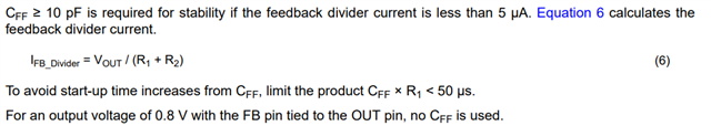

Hello team,
Currently my customer is reviewing TLV76701 for their induction project.
They want to do 12Vin 5Vout, and asked which feedback resistors they should use.
Based on quick calculations I thought R1 = 787kohm, R2 = 150kohm would be suitable,
Could you please check below calculations, and would it be ok if they used these values? I just wanted to double check to make sure.
i) VOUT = VFB × (1 + R1 / R2)
5 = 0.8 x (1 + R1/R2)
R1/R2 = 5.25
ii) R1 + R2 ≤ VOUT / (IFB × 100)
R1 + R2 ≤ 5 / (50nA × 100)
R1 + R2 ≤ 1MΩ
R2 = 150kohm
R1 = 787kohm
Thank you in advance for your help and support.
  • Hi Jade,
    Those values will work as expected, they divide correctly, ensure IFB is negligible, and don't require a CFF.
    I'd note that feedback divider current (Vref/R2) is 5.3uA which is just barely above the 5uA cutoff for requiring a CFF.
    If you want to create a wider margin when not including a CFF, you can cut reduce both.
