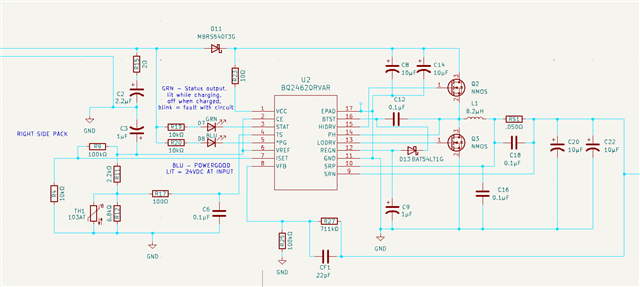

BQ24620: Struggling to get batteries to charge
Part Number: BQ24620
I have been working on this since my last post, the schematic is below. This charger is set to charge at 300mA to 14.6 volts. I have a 4S1P pack attached to this charger. The two lines coming in from the left is our 24VDC and our GND, the line exiting to the right leads to the battery pack.
The status of the charger is blinking, and I am not sure why it is in a fault. Please let me know any steps to take or considerations I may have missed. All my values were chosen using the design calculator I downloaded from the product page.
Thanks in advance!
