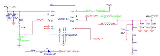

TLV62585: Max leakage current of EN pin
Part Number: TLV62585
HI ,
Below is our schematics
The VOUT will be 3.8V and C320 we will keep NM.
We have to fine tune the RC circuit on the EN pin to adjust the power sequence.
For that we want below info
"What is the Max leakage current of EN pin, when EN pin is at 4.6V
