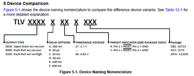

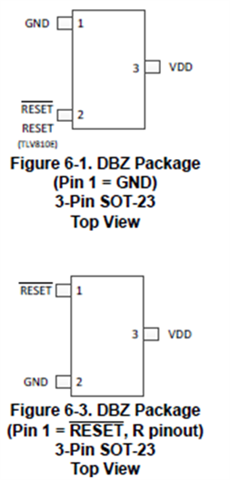

When comparing the Device Naming Nomenclature with the package top view figures, I am seeing what appears to be a discrepancy.
Note the Pinout Indicator. This does not match the below:
I need the Figure 6-1 pinout, which I think is the TLV809EA29DBZ (Push-pull Active Low, 200ms, 2.9V, SOT23, with RESET on pin 2).  Can you please verify that for me? Thank you!
