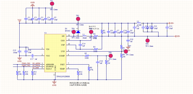

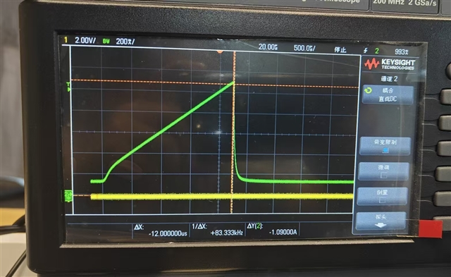

  Hello, we are using tps922052 for optical pulse output. It takes more than 2ms to light up the LED with this chip for the first time, but we would like the rise time to be in microseconds, similar to the LM3409. We want the LED to stay lit for 10us before turning off, but the LED's hysteresis effect is too pronounced. Do you have any other chips that can do pulse output? How can Mr. Hu design with this chip to meet my requirements?

    Thanks for reaching out! May I know the reason to choose other LED drivers but not LM3409? Is it because customer prefer integrated FET solutions. LM3409 is hysteresis control and TPS922052 is constant off time peak current control. So that the response time performance is different. Besides, the internal ADIM and PDIM operation is different.

  • Hello, the optical power stability of TPS922052 is very good right now, but the startup time is too long for us to accept. We also tested the LM3409, which has a very short startup time, but when using analog control, the minimum current is still 20-40mA. Such a small current is not acceptable for optical dimming using PWM, so we are currently unable to solve the shortcomings of both chips.
