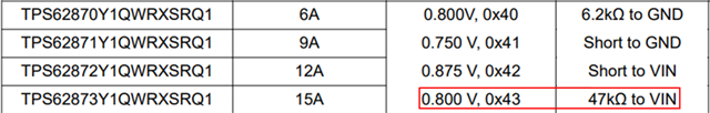

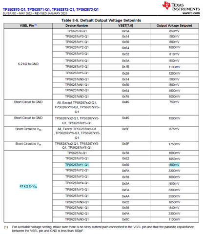

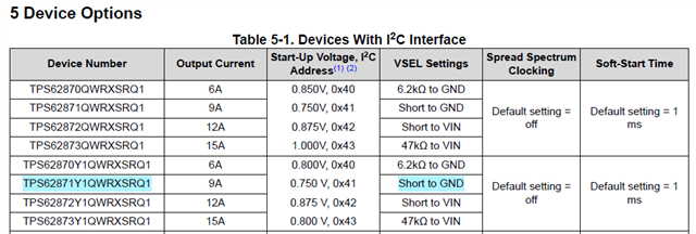

I want to output 0.83V with the TPS62871Y1QWRXSRQ1.
I think I'll need to set it via I2C.
In that case, does VSEL need to be set to "Short to GND"?
Is I2C setting possible when it's set to "47kΩ to VIN"?
