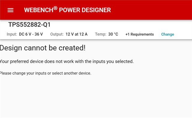

I am planning to use TPS552882-Q1 in my design with the following parameters
VIN - 8 to 36 V
VOUT - 12/5/3.3V
IOUT - 16 A
Operating Temperature - -40 to 125 deg C
Will this work?
I am unable to simulate in Webench with this chipset
What will be the design's efficiency?

  • Hi Baghiya,
    Will the device need to output 16A? If so, I am afraid TPS55288 can't support it due to avg current limit (14A min).
    Could you explain the max output current for each output rail separately?
    VIN - 8 to 36 V
    VOUT - 12/5/3.3V
    IOUT - 16 A
    BRs,
    Bryce
