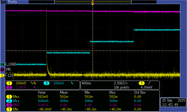

Hi Experts,

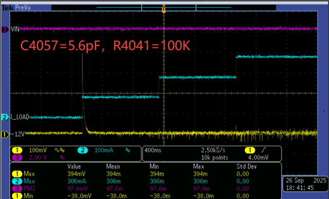

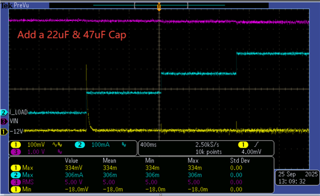

We used TPS65131RGER for +/-12V,300mA max output with 5V input,we are facing big overshoot during loading switching from 0A to 100mA,any advice to improve?
*We tried to add some 22/47uF ceramic cap at the output and adjust the Cff,failed to improve.
