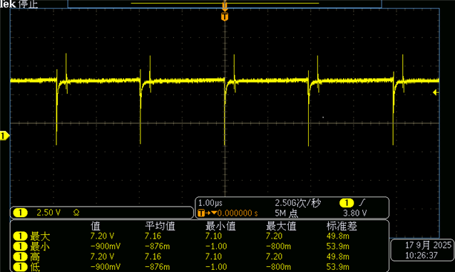

TPS53353,VIN=12V,Vout=1.2V,Iout max=16A; oscilloscope use High voltage differential probe measurement,bandwidth=500MHz。
1)Rbst=5ohm,Cbst=0.1uF at 16A load,test LL pin6 Phase switch Ringing max=23.9V;VBST-LL(pin4/pin6) max=5.85V,min=250mV。
2)I see SLUA831A document,add Rs+Cs,Rs=1ohm,Cs=470pF; VBST-LL(pin4/pin6) max=7.20V,min=-900mV ; exceed the standard.(at 16A load).
3)I try Rs=0ohm~5ohm range,Cs=100pF~3.3nF range.The smaller the Cs, the lower the voltage VBST-LL.

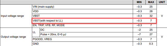

1)VBST-LL Is there any risk beyond the range of -0.3~7V?

    1. Yes you should not cross the datasheet absolute max limits else it may not work as per the specs mentioned in the datasheet and even may get damaged.
    2. refer SSZTBC7 Technical article | TI.com
    3. Yes, it may affect.
    4. 500 MHz is sufficient.
    you can check your layout and also try to reduce the Switching node ringing which will help reducing the BST-LL ringing.
    -Hitesh

        4)Rbst=5.1 ohm,Cbst=0.1uF, BST-LL ringing range is ok. but Switching node  have ringing,Can we not increase Rs, Cs?
        5)VBST-LL range spec is DC value,Can we accept ~ns pulses, similar to LL?

    5. No VBST-LL should not go above the absolute ratings, solving the switch note ringing will reduce this voltage.
