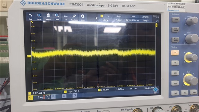

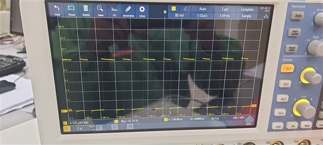

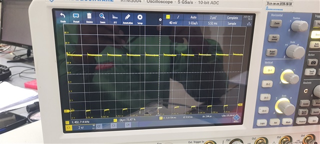

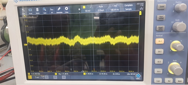

I'm using LM51343 for converter (9V to 12Vin, Vout1- 8.5V at 5A and Vout2 - 5V at 5A). At 12Vin my converter was working fine.
But 10.5Vin my 5V output starts to oscillate at 1Khz to 5Khz. So I suspected it was compensation loop issue.
So I disabled the 8.5V and tested the 5V output. It was working fine and no oscillation at output.
Also I disabled the 5V and tested the 8.5V, No oscillation at output.
But I tested it dual output configuration. The 5V was oscillating.
Also it switch node was oscillating at cycle by cycle.
My inductor value 6.8uH, DCR 6.15m ohm
CS RC value:
5V: 7.5K ohm & 0.2uF
8.5V: 12.7K ohm & 0.1uF
Compensation value
C: 330pF
RC: 20K ohm & 0.01uF
5V switch node
Roshan
