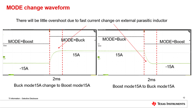

Hi
I would like to understand the response delay of transition from Buck to Boost mode. not find it in datasheet, thanks
