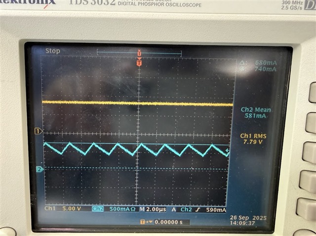

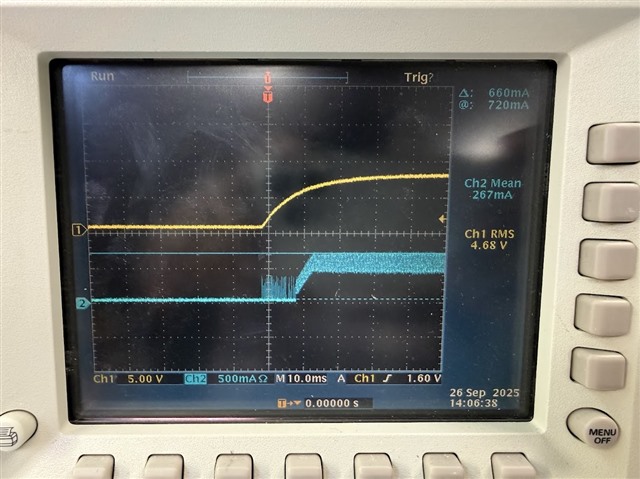

  1. Tail input only: LED turns on instantly (as per the schematic).
  2. Tail + Stop input: LED reaches full brightness instantly.
  3. Stop input only (without Tail): LED initially turns on, then briefly turns off for a few milliseconds before returning to full brightness.
On my bench, increasing the buck converter output voltage by ~1 V appears to resolve the issue. The actual Vout is approximately 10% lower than the calculated value, giving 6.10 V, whereas the LED regulator requires ≥6.7 V for proper headroom. I am not certain if this is the root cause or the definitive fix.
There is no issue during steady-state operation; the LED operates normally once at full brightness.

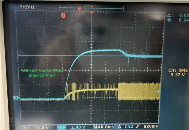

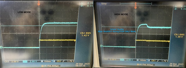

    Can you kindly probe the Enable pin and see its waveform during the aforementioned phenomenon during the startup?
    Also, can you probe the pin 1 of the L2 inductor and see if there is any difference between the 3 cases you mentioned (Tail, Tail+Stop, Stop)?

    The Enable signal has been verified and is clean during startup (waveforms attached).
    The problem is observed across the entire input range.

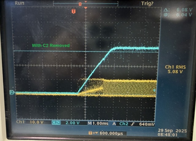

    We identified the root cause: C2 = 0.1 µF across R1. Removing C2 resolves the issue.
    Attached are the waveforms with C2 in place and with C2 removed.
