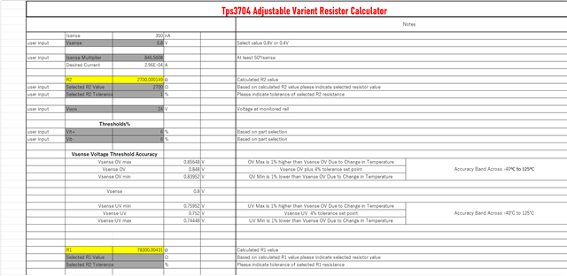

TPS3704-ADJ-CALC: Regarding the Isense multiplier
Part Number: TPS3704-ADJ-CALC
Hi team,
Since Isense is 350nA, I set the Isense Multiplier to 846.5608 to get closer to the desired R2 value of 2700Ω.
This value exceeds the recommended value of 50, so I would like to know if it can still be used without any issues.
