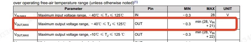

I would like to confirm that according to the specification of the Vout Absolute Maximum Rating value, does it mean that when the input is 0V, the maximum pin voltage of output pin is only 0+21V = 21V?
