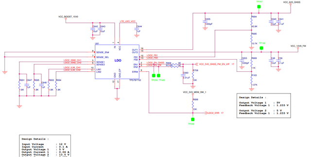

Hi TI team,
Please help to provide SCH review for the below design.
  • Hi Ram,
    Power dissipation and output voltage looks correct, though the design details table voltages appear to be out of date.
    SENSE and ILIM resistors do not appear to be correct for the listed output currents. Datasheet equations 3 and 4 (section 8.2.2.3) describe how to calculate these values.
