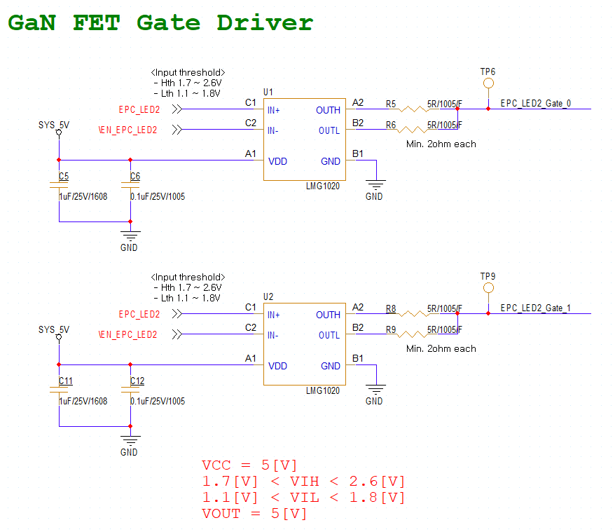

Dear TI experts,
My customer made their schematic using LMG1020. Could you review this schematic?
Chase

Hi Chase,
The only comment I have is that the smaller VDD bypass capacitor may need to be increased to 0.47uF, depending on if customer is seeing a lot of noise on VDD (0.1uF may be fine depending on the application). Otherwise, I have no further feedback.
