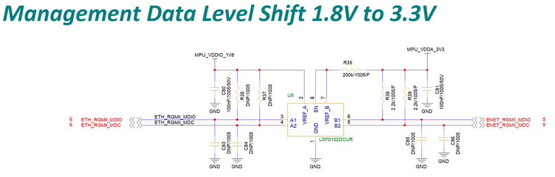

Dear TI experts,
My customer made their schematic using LSF0102. Could you review this schematic?

Hi Chase,
My understanding is that MDIO requires external pullup on the line during the event of a HIGH-Z state on the bus. Please check if it is populated outside of provided schematic on A-side. Aside from this, I do not see any other immediate concerns.
Jack
