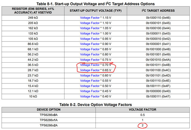

TPS62869: Start-up Vout not shown in table
Part Number: TPS62869
Buck regulator team,
Our TPS628692A has a table in the datasheet for the Startup voltage based on the resistor on the Vset pin.  Our customer needs a startup voltage of 1.35V.  This is not in the list.  If I interpolate a value between 1.3V and 1.4V, I get R = 32.6 kOhm.  Can we use that value to set a startup voltage that is not in the list?
