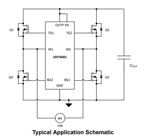

Max Switching Frequency of this part? I don't see it in the datasheet.
thx
Unclear. The name of the part is "100V Ideal diode bridge controller for PoE powered applications". The datasheet schematic shows the device switching an H bridge. How can you have an H bridge without switching?
It appears that the input signal is switching the mosfets, rather than a clock, like a bridge rectifier. What's the max allow input frequency?
Hi Johny,
POE powered applications do not have switching.
It seems to be an HBRIDGE but LM74680 and LM74681 share the same schematic.
680 uses HBRIDGE for switching and 681 uses HBRIDGE to polarity agnostic application.
Shiven Dhir
The expected input for both devices is AC, correct? 680 datasheet says "The LM74680 supports voltage rectification from DC to 1kHz."
