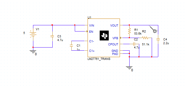

I could not get PSPICE transient simulation for LM27761 to converge. I was trying for -2.5V supply. What could be the issue?

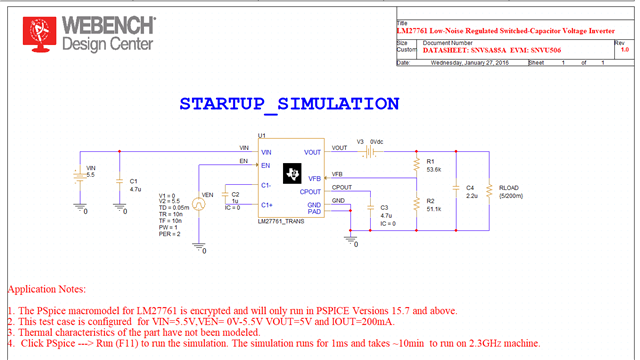

Please use the PSpice model from the device web page https://www.ti.com/product/LM27761#design-tools-simulation

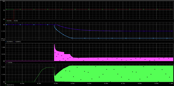

I have modified the schematic to Vout= -2.5V and it is working
