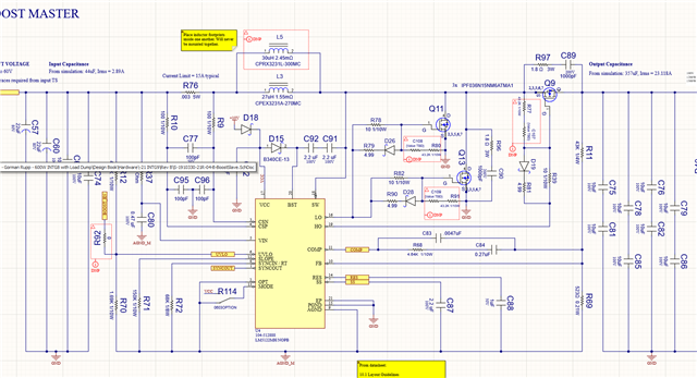

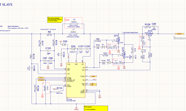

  • Here are snippets from my schematic, master and slave configuration. I'm using a 30uH inductor currently with a large saturation current rating.
    Yes, we did use the design tool initially. This design is based on those calculations.
    We're running at a pretty low frequency (140Khz) in order to reduce heading in low side FETs but the ripple current shouldn't be out of hand.
    I appreciate your thoughts!
  • Hi Brian,
    Thanks for the explanation and the schematics.
    I did not see any problems within the schematic structure.
    The main issue is like you already pointed out: The abs max rating of SW is 105V, while your typical SW rises to 100V.
    Meaning any overshoots of more than 5% will come with a risk of damaging the device.
    Unfortunately, we do not have any other synchronous boost controllers in our product line portfolio that can support higher switch node voltages. The next best option would then be to switch the whole topology to a system more suited for 1.5kW power ratings.

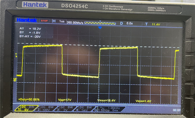

  • Here is a scope capture after bumping the voltage down to 93V for continued testing. This is captured with a differential probe across AGND and the SW net plane (I can't easily get right at the pin so it might see something slightly different).
    The scope probe is x50 so you need to multiple the values by 5x to get the true voltages. I don't notice any/much overshoot @ this voltage. I do see a shift on the GND side which I'm not positive if it's real or not but based on the amplitude (18.4V x 5 = 92V) it does look like it is real. Otherwise, I would be seeing slightly less voltage at the output (Meaning if 17Vpp was the total swing I would only be seeing ~85V at the output).

  • Hi Brian,
    Thanks for the waveform.
    I agree with you that there seems to be no overshoot at in this measurement.
    The GND shift is rather confusing. I would consider a GND shift of ~10V rather abnormal, so I would expect this to be a measurement artifact and not the actual pin voltage.
