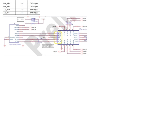

Could you please help confirm that the TUSB542 14/15, 17/18 Pin Functions and EVM are opposite to those in the datasheet?
HI,
The EVM was released on an older version of the silicon. Please use the datasheet pin functions as these are the latest.
