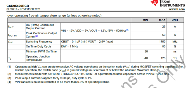

We are going to use the CSD95420RCB as suggested by TI. Our application requires a continuous current of 34 A for up to 2 msec. However, when reviewing the datasheet, we noticed that the peak output current rating is specified for 500 µs. Could you please confirm whether the device can safely support a continuous peak current of 34 A for up to 2 msec in our application?
For your reference, we have attached the CSD95420RCB datasheet screenshot. Kindly review and provide your feedback at the earliest.
