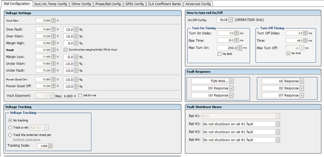

In +18V to +12V design, UCD9248 is used with UCD7242 at 750KHZ.
A problem was found during debugging with TI Fusion digital power designer software, such as accessory images.

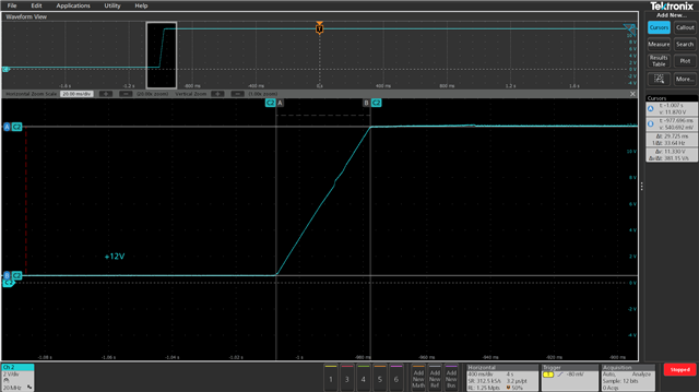

When setting the Rise time of +12V, the minimum is only 30ms. Even if the configuration screen is set to 20ms, the actual waveform is 30ms.
 what is the upper and lower limit of the debug parameter Rise time? What do I want to do to adjust the actual rise time to 10ms?
