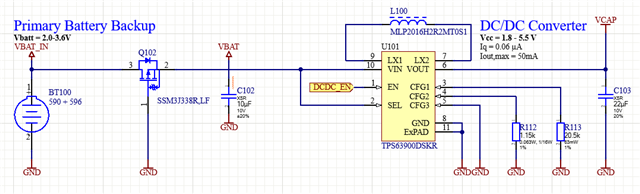

We use a Supercapacitor as our main energy storage element. It is mainly charged by solar power, but should also be charged with a primary battery as a backup.
For this we use the following circuit (the supercap is not shown, but is connected to VCAP), which charges the Supercapacitor up to 3V, whenever it should fall below that threshold. The supercap voltage can also be higher, if it is charged by solar.
Can you please confirm that the schematic shown is correct?

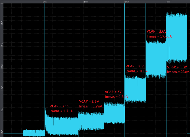

However, the circuit should also be usable if no backup battery is inserted (VBAT_IN is floating). But right now I measure a large reverse current going into the VOUT pin of the TPS63900, depending on the supercap voltage up to 23uA at VCAP = 3.8V.
Is this behaviour normal? Can the reverse current flowing into the TPS63900 be avoided?

  • Hi Steven,
    I verified on EVM and similar leakage into Vout pin was observed. I also checked that if pull the EN to low, when Vout >= 2.8V, the leakage into Vout pin can be reduced to ~10nA. But if the biased Vout is 2.5V, there is still a ~1.7μA leakage into Vout pin.
    In you application, can the DCDC_EN be pulled low when the battery is not inserted? That is, when there is no battery, disable the device can reduce the leakage into Vout pin significantly.
    Lei
  • Hi Lei,
    Thanks for your answer, these results match with my measurements. Unfortunately, that means that overtime, the LiC Supercap that we use will be drained and thus damaged. We are currently reworking our power concept for this design, because the TPS63900 does not seem appropriate for our needs.
