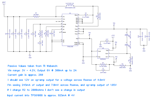

I'm trying to use the TPS61088 as an LED driver with a single 18650 lithium ion battery with a voltage range from 3V-4.2V. I'm driving two 3V LEDs in series between 300mA and 1.5A, and I have a 30mohm low side sense resistor and I'm measuring the voltage across it with a non-inverting op-amp and running it into the feedback pin of the regulator. It was my understanding the regulator would drive the output to regulate the voltage at the FB pin to 1.204V. I'm not seeing that. My notes are in the image. I pulled the passive component values from the TI Webench. If you need scope views from any node I can provide them.

    Please measure as well the output voltage. In addition, I recommend checking the OpAmp first without the connection to the TPS to be sure that the input and output signals fit.
    If the feedback node is at 1.95V, the device will not switch as it is already way too high.
