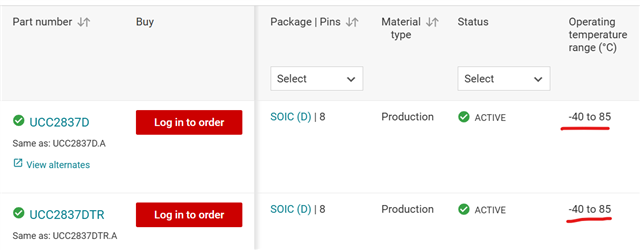

Hi team
There is a Electrical characteristics data at -25~85C in the datasheet.
But TI guarantees this device -40~85C.
Do you have a Electrical characteristics data at -40~85C ?

Hello Koji,
Unfortunately, I was unable to locate any characterization data over temperature. The device was originally released to the market by Unitrode Inc, which was acquired by Texas Instruments in 1999.

Does TI guarantee operating temperature range -40~85C ?
Best Regards
Koji Sakurai
Hello Koji,
As documented in the datasheet, the specified operating temperature ranges are as follows:
TA = –55°C to 125°C for the UCC1837,
–25°C to 85°C for the UCC2837 and
0°C to 70°C for UCC3837;
Daniel
Hi Daniel
OK. I understood -25C to 85 is operating temperature range.
Can you modify below information on TI.com ?
Best Regards
Koji Sakurai
