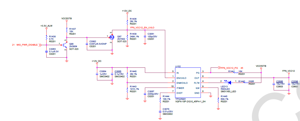

Would you please help review below schematic? thanks!
Hi Jeff,
The schematic overall looks fine but doesn't have any transient protection. If any high slew rate event is possible, then transient protection is recommended (TVS at input, Schottky at output)
My colleague will get back to you here. Please send the layout to him.
