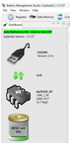

The default SMBus address is 0x16 according the the TRM.
Just wondering why it shows up at 0x17 in bqStudio?

Check out https://www.ti.com/lit/an/slua475/slua475.pdf, chapter 1.1, item #4.
