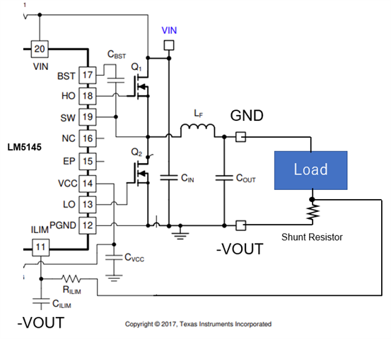

Hello team,
My customer would like to use LM5145 in sink application.
Currently, their board successfully sink current even up to 10A or more.
However, they realized overcurrent protection is not working during current sink operation.
(They are using MOSFET RSDON current sensing)
Is there any way to implement overcurrent protection during sink application?
Addin external components or devices are acceptable.
