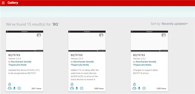

As of now, is BQ797XX ver.2.0.4 latest version to evaluate BQ79758EVM (confirmed -V is mounted.)

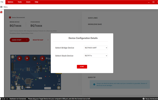

Also, if we evaluate mulitiple EVMs (79600+79758(bottom)+79718(upper)) how can I set the bridge and stack device? We only can select 2 device.
Yuto
  • Hey Yuto,
    The 758 and 718 are interchangeable on the GUI. If you select 71x as the stack device, it should function fine. Additionally, the EVM will automatically detect how many of those devices are in your stack during setup.
