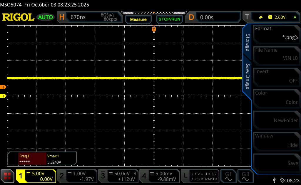

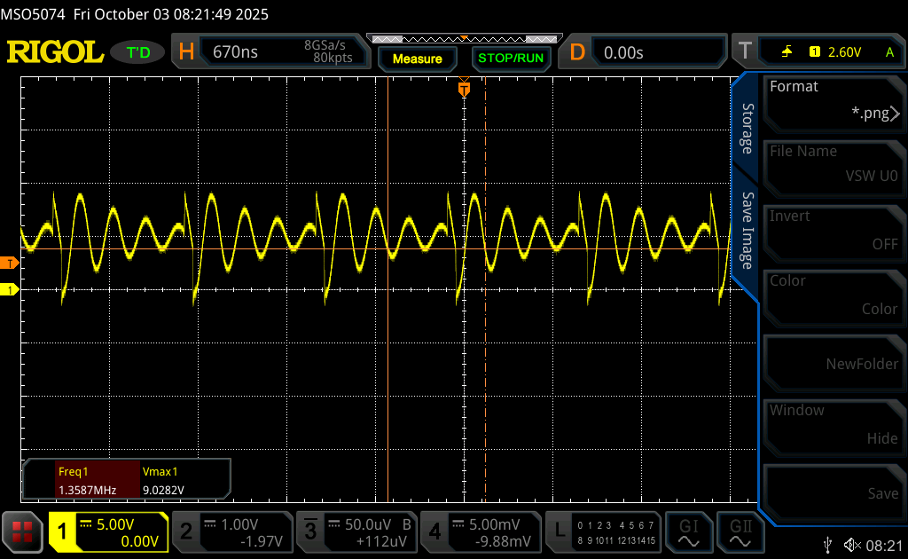

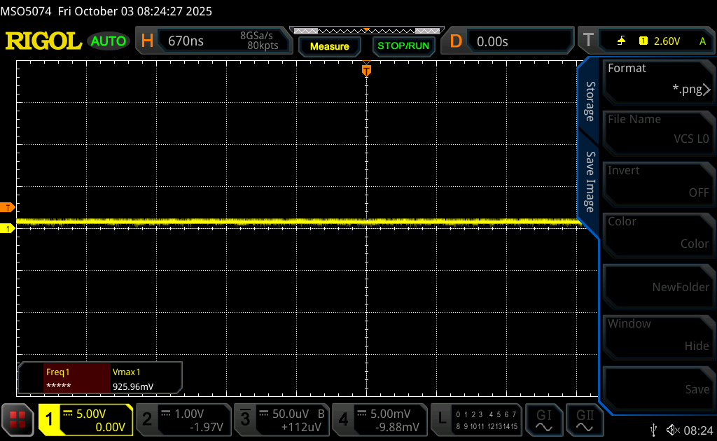

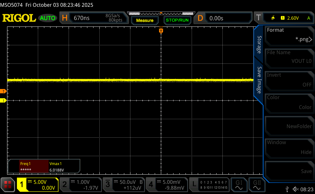

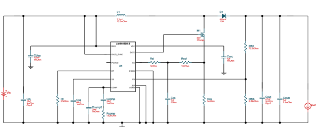

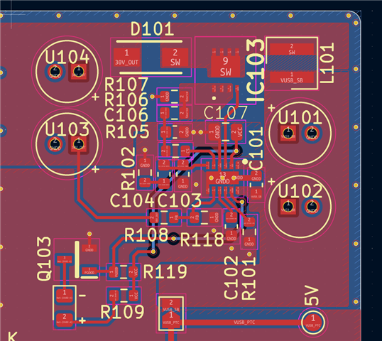

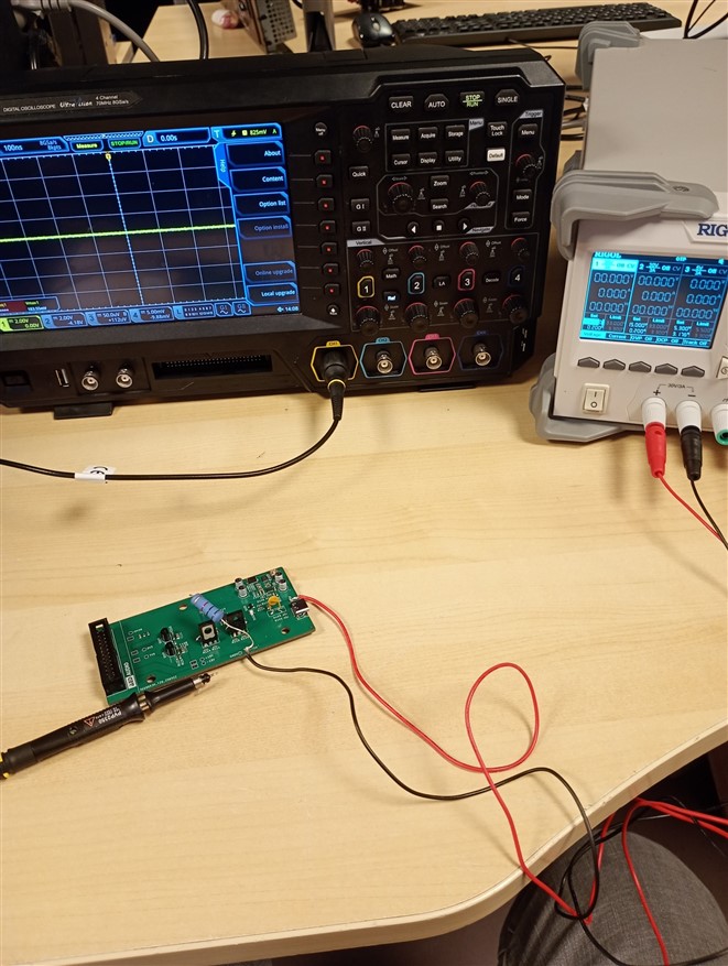

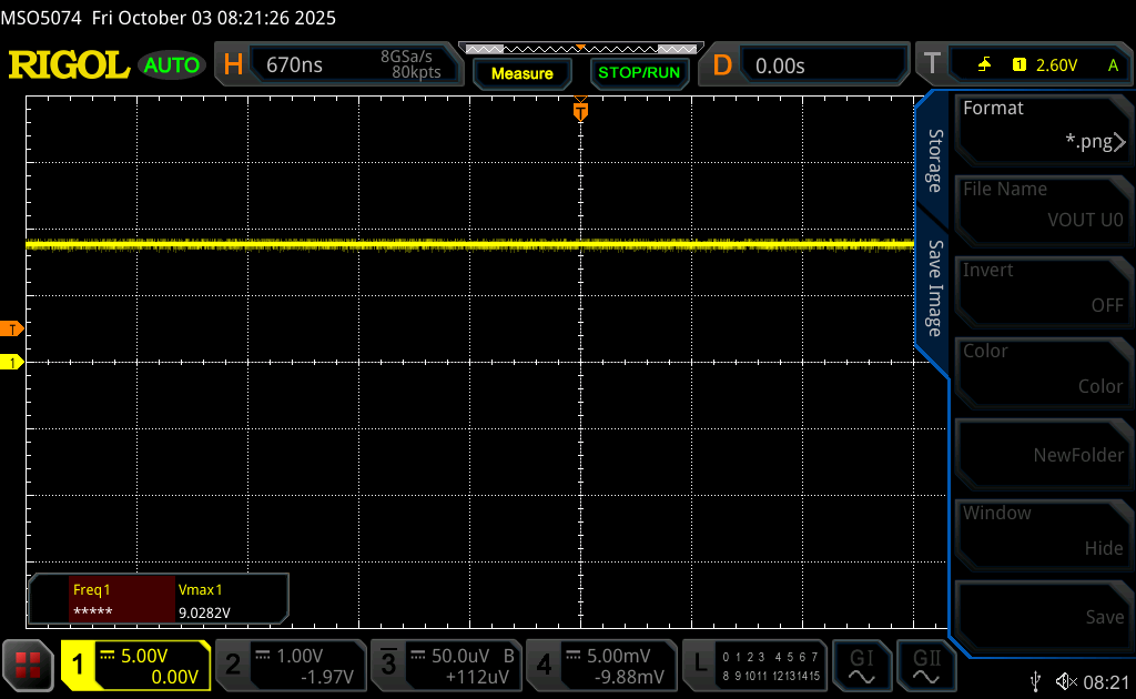

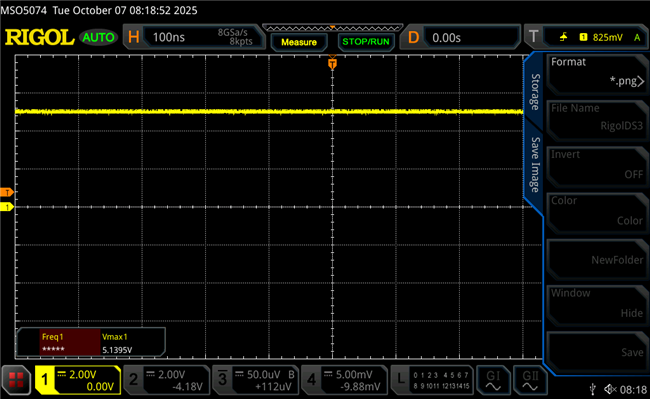

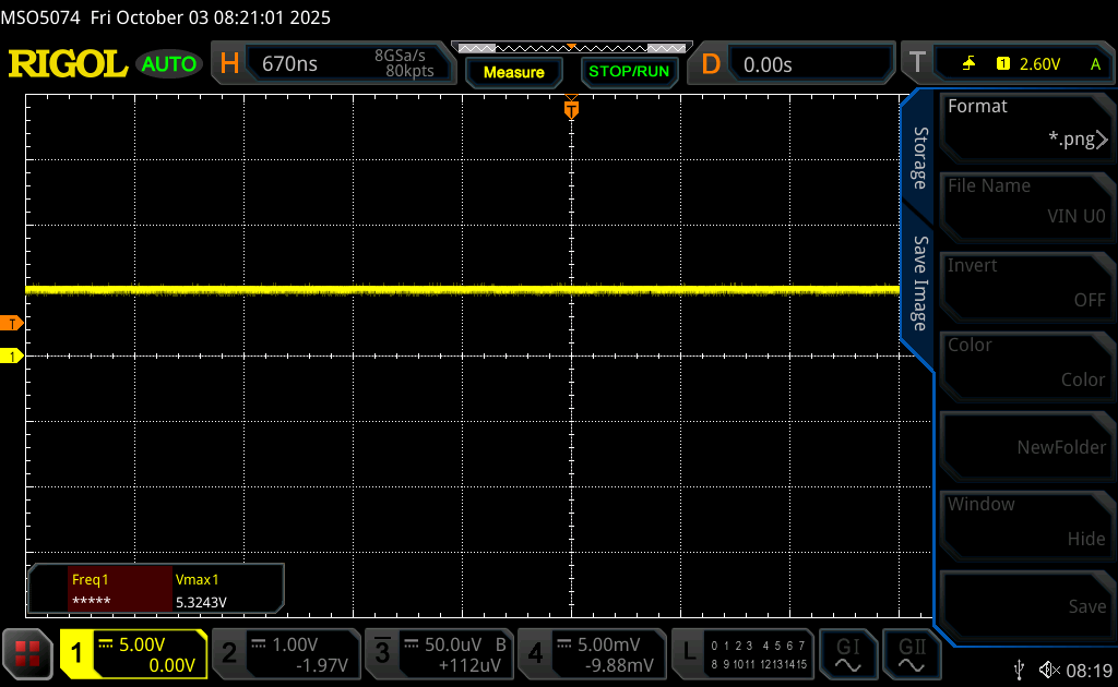

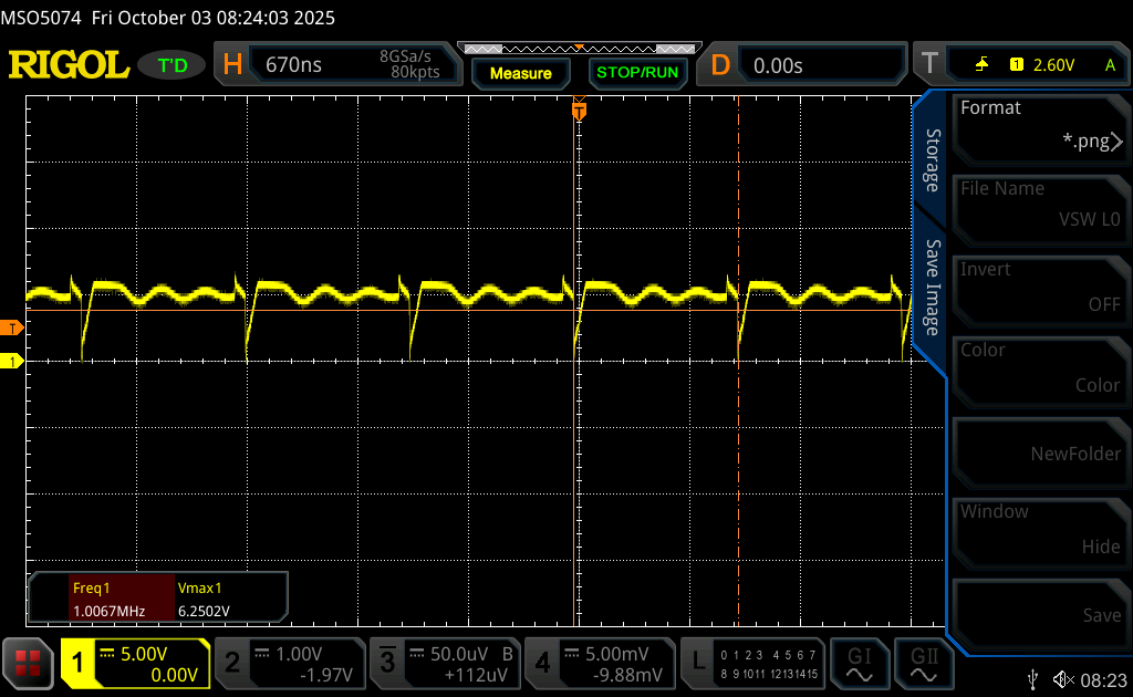

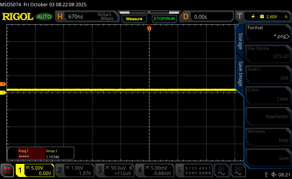

I'm using this converter to boost 5V to 30V.
But when I measure the output unloaded I get 8.5V on the output.
When I load it with a 1K ohm resistor it collapses to 5V.

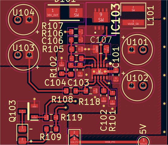

I double checked the datasheet but can't immediately find anything wrong.
Any guess on what could be the problem.
I have 5 pcbs all with the same problem, so I'm pretty sure it isn't a solder problem.
Thank you in advance,
