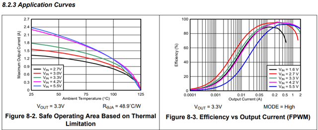

Hi team,
I have the following questions:
1. Regarding the Application Curves, could you provide the curves for Vin = 2V in both Figure 8-2 and Figure 8-3?
2. In the curve of Figure 8-2, if the output current is an AC waveform (e.g., ~1kHz sine wave),
 is it required that the maximum instantaneous current of the waveform must not exceed the specified Maximum Output Current,
 or can it be evaluated based on the average current?

    The curves will have a very similar shape as the black ones. On the left side, it will start somewhere around 0.8A to 0.9A and then as well fall like the black one.
    On the right, the efficiency is between the black and the red line with a similar shape, but get to roughly 0.8A to 0.9A.
    It takes much effort to add the "two curves" in datasheet, sorry there is no plan to update the datasheet now.
    Thanks to Brigitte's comment, which is a very good estimation for the conditions when Vin = 2V.
    I suggest to uses the RMS current for the max Iout estimation.
