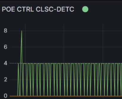

I want to verify whether or not this is an expected behavior when I configure the TPS23881 as an auto-class 4-pair port, and connected to a 2-pair PD (Type 2).  I see the PD load powered up successfully but I continue to see the the Detection Event Register (0x05h CoR) indicating a detection cycle occurred when I poll status on the I2C bus.  Is this due to the fact that the other pair is left unconnected?

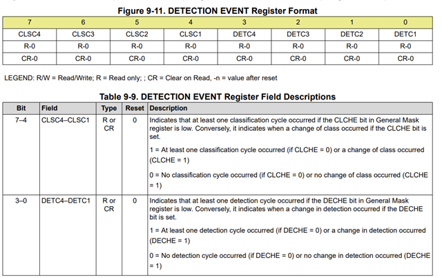

  • Thank you for investigating, attaching an image below for reference.  I'm reading out the (0x05h) register that clears on read.  When I first enable the channel I see the detection at 8 (0b1000), which corresponds to DETC4, then goes to value 4 for DETC3 (0b0100).
    Interesting though is that I thought on the cycle where the value read out 8, I thought it would be 12 (0b1100), corresponding to a detection cycle on both DETC4 and DETC3.

  • Interesting... I think this is similar to what I'm seeing.  In my setup I don't have the first port connected and not enabled so I don't expect DETC1 and DETC2 to go through a detection cycle and flag.
    On the PD side I just have 2 pairs connected to the diode bridge with the other 2 pairs unused and unconnected.
    When I connect to a 4-pair PD I see the Read Detection Event register (0x05) flag in one cycle but then once it's powered up the register is cleared and does not keep indicating it's going through detection.
