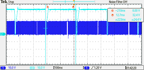

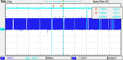

  • Thanks for responding Yamini. Here are some screenshots of the waveforms I am seeing. Channel 1 (Dark Blue) is LO and Channel 2 (Light Blue) is my output voltage.
    Once I hit the power limit at about 1050 W LO stops switching for about 5 ms, making Vout drop to 0 V before restarting.
    This cycle repeats itself about every 200 ms. In each cycle you can see that there is another period of time where LO stops switching but Vout does not drop which I am also confused about why that occurs.
    Channel 3 (purple) shows the input current from my power supply. Once I hit the output power limit (shown on the left at cursor a) my output voltage remains at 34 V, but the input current starts ramping up until it hits the current limit of my power supply (5 A in this screenshot), where it then starts the cycle of the output turning on and off I showed before. This happens no matter what I set the current limit to, but the duration between shutoffs once the current limit is hit changes.
    This shows that during the input current ramp up I showed in the previous image, LO stops switching periodically, even before the output voltage starts dropping.

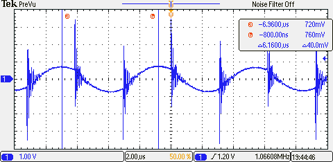

  • Hi Christopher,
    Thankyou for the waveforms.
    Can you please probe your ISNS and check whether it us crossing 3.5V or not .
    Yamini.
  • This is ISNS right before I hit the power limit, when my LLC was working fine.

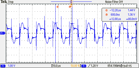

    This is ISNS after I hit the power limit.
  • Hi Christopher,
    From the waveforms, if I am correct ISNS is not crossing 3.5V. We need to check whether Vfb replica is around 4.75V for higher power (>1050W).
    Can you please send your schematic and design excel sheet.
