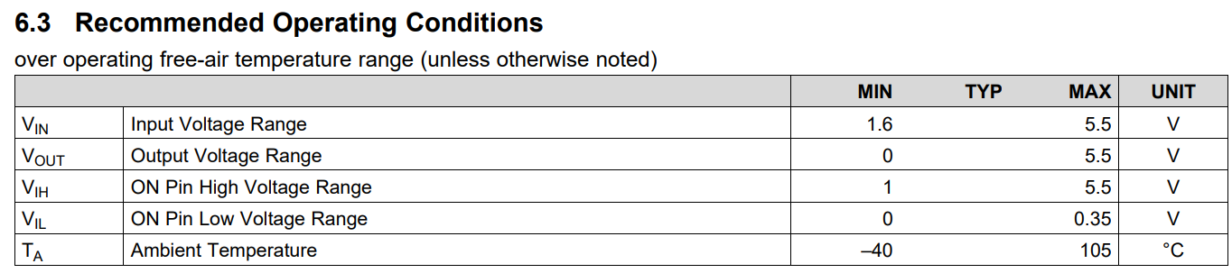

TPS22919: Ripple in ON trigger?
Part Number: TPS22919
What is the min voltage to trigger the ON pin? 1V? How will the device respond to ripple on the "ON" pin? Is it ok, as long as the ripple never drops below "ON Pin High Voltage Range - MIN" of 1V, and never exceeds "ON Pin High Voltage Range - MAX" of 5.5V? Or do we need a smoothing cap on the ON pin?
