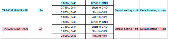

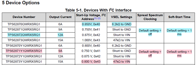

I am considering changing from Q1 devices to non-Q1 devices.
Are the following changes functionally equivalent and don't I need to make any design changes?
TPS62872QWRXSRQ1
TPS62872Z4WRXSR
TPS62871Y1QWRXSRQ1
TPS62871Z0WRXSR
Dice-K
