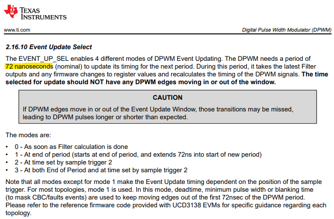

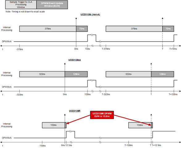

    The minimum time it takes between a sample trigger and a DPWM moving edge based off the Front End eADC measurement is 450ns in the UCD3138. We also have the Event Update Window (EUW), which is the time it takes for the DPWM moving edge to update its position after reading the PID output. This is 72ns in the UCD3138. Fixed edges can still occur in the EUW (Ex. if Event 1 is fixed, you can have it in the EUW), but a moving edge cannot be in the EUW).
    See the "Event Update Select" section on page 55 of the TRM.
    Below is a comparison of the Event Update Window and Sample Trigger to CLA Processing Window. The Sample Trigger to CLA Processing Window is the time it takes for the Front End sample to generate a PID output while the EUW is the time it takes for the PID output to update the DPWM moving edge position. The upcoming UCD3138R will have a much faster processing time. Please contact your local FAE for more information on the UCD3138R.

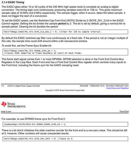

    4. I have seen that the ADC can be triggered by several sources (such as DPWM frame start, output pins, etc.), but I don’t see any way to configure it to sample repeatedly at the maximum possible rate. How should I set up the sampling triggers or clocking so that I get the fastest possible continuous sampling? Where in the documentation can I find the exact configuration registers or limits?
    See the "EADC Timing" section on page 113 of the TRM.
    Our UCD3138PSFBEVM-027 uses Peak Current Mode Control (PCMC) for the PSFB topology. You can view the UCD3138FW-PSFB for example code.
