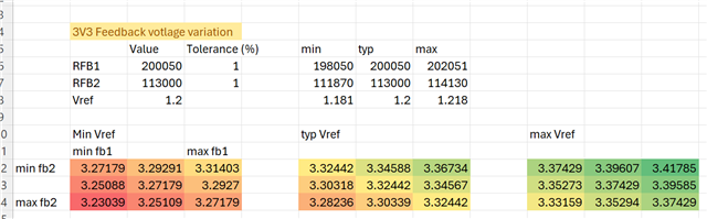

    On another note, I'm also finding that my steady state voltage is higher than what is expected from the feedback loop both in the Webench simulation and in my scope shot.
    With a 200k and 113k configuration I expect a voltage of 3.32V but in simulation I get 3.5V and in application I get 3.4V.
    Can a TI member provide the feedback pin input current specs and the spice files for the LM5012 to better simulate my setup?

  • Hello Arman,
    Take note that the reference voltage of the device does have a max and min, this could have an influence on your output voltage.
    Additionally the accuracy of the resistors used will have an influence. For example 5% resistors can lead to greater variation in output voltage compared to 1% resistors. Unfortunately, i have consulted the team and there does not appear to be a simulation model available at this time.

  • Hi Oscar,
    Yes, I've looked into that as well.
    Considering the absolute worst-case tolerance of my 1% resistors and the Vref variation, my output voltage makes sense.
    I just wanted to confirm that I wasn’t overlooking any other factors, specifically whether the input bias current of the feedback pin could have been influencing the voltage divider.
    Arman
  • Hello Arman,
    Your number look good, that is typically what i would expect. I don't believe there is anything being over looked in this case.
