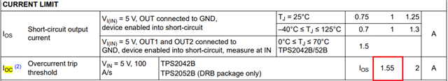

We have question about the conditions under which the /OC pin of the TPS2041BDBVR transitions to low.
As shown in the capture below, is it correct to understand that when an overcurrent of typical 1.55A is detected, the /OC pin transitions to low?
We evaluated and captured waveforms.
When the current at the OUT pin was increased to about 1.522A with the /EN pin enabled, the /OC pin transitioned to Low.
