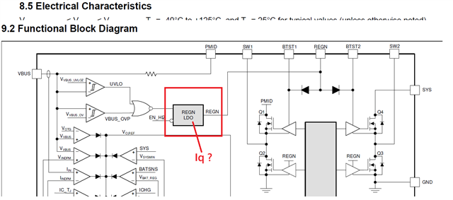

  • Hi Jeff,
    Thanks for your reply.
    What’s the Iq for REGN LDO ?
    If Iq is out of my expectation, Can I turn it OFF for power-saving?
    If not, how can we reduce the Iq of REGN LDO?
    Thanks!
    Alice
  • Hi Alice,
    We do not have Iq for REGN broken out from the rest of the charger.  REGN output is only available when valid VBUS voltage is applied. If VBUS is applied, the charger can be forced into high impedance (HiZ) mode (similar to when no VBUS is applied) by setting EN_HIZ bit =1 but that also turns off the converter and turns on the BATFET so that SYS=BAT.
    Jeff
