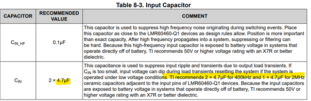

HI TI Expert,
Could you help to clarify the CIN 4.7uF here refer to nominal capacitance or the effective capacitance after consider derating?
Thank you.
Hello Evan,
In the case of input capacitance you can consider this spec to be nominal capacitance.
Oscar Ambriz
